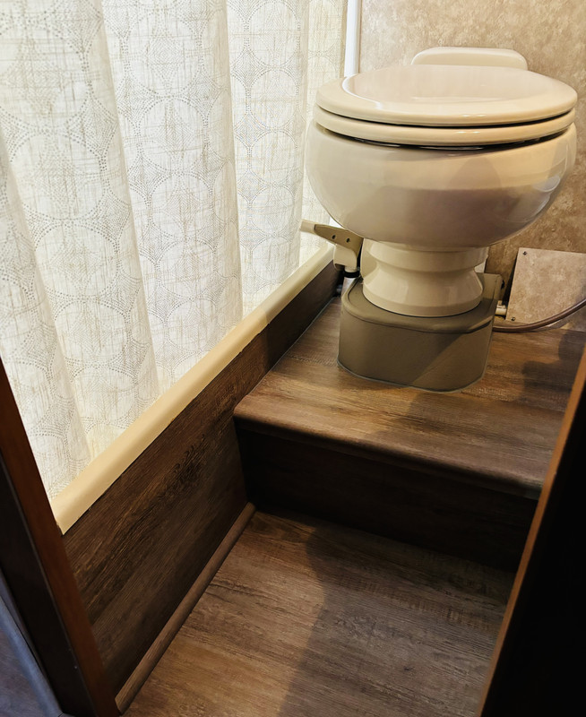

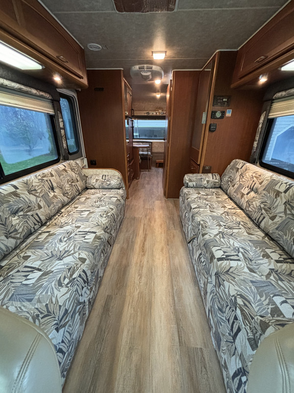

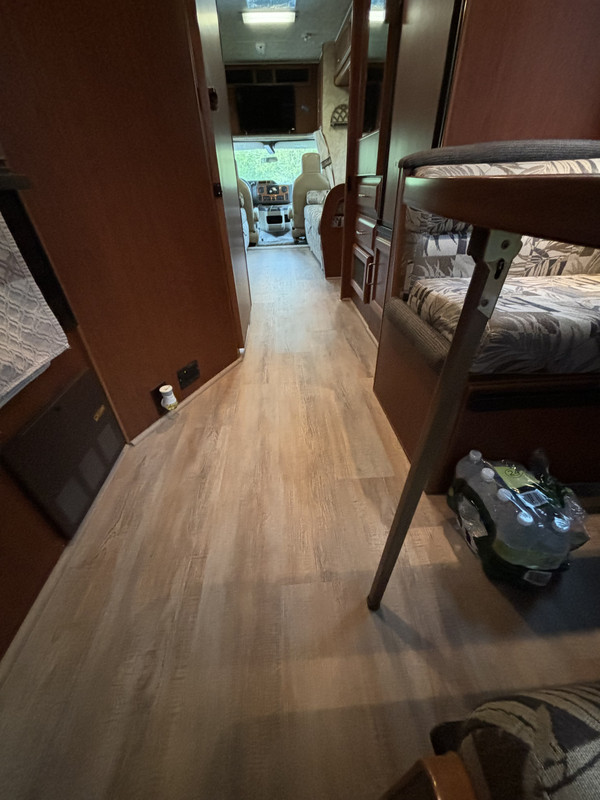

I just finished the floor. I left the grey cab carpet for now. I may never swap it out. It’s in nice shape. Well, as nice as cheap house carpet can be. Here are a few pictures of the project.
After tear out.
Finished product
