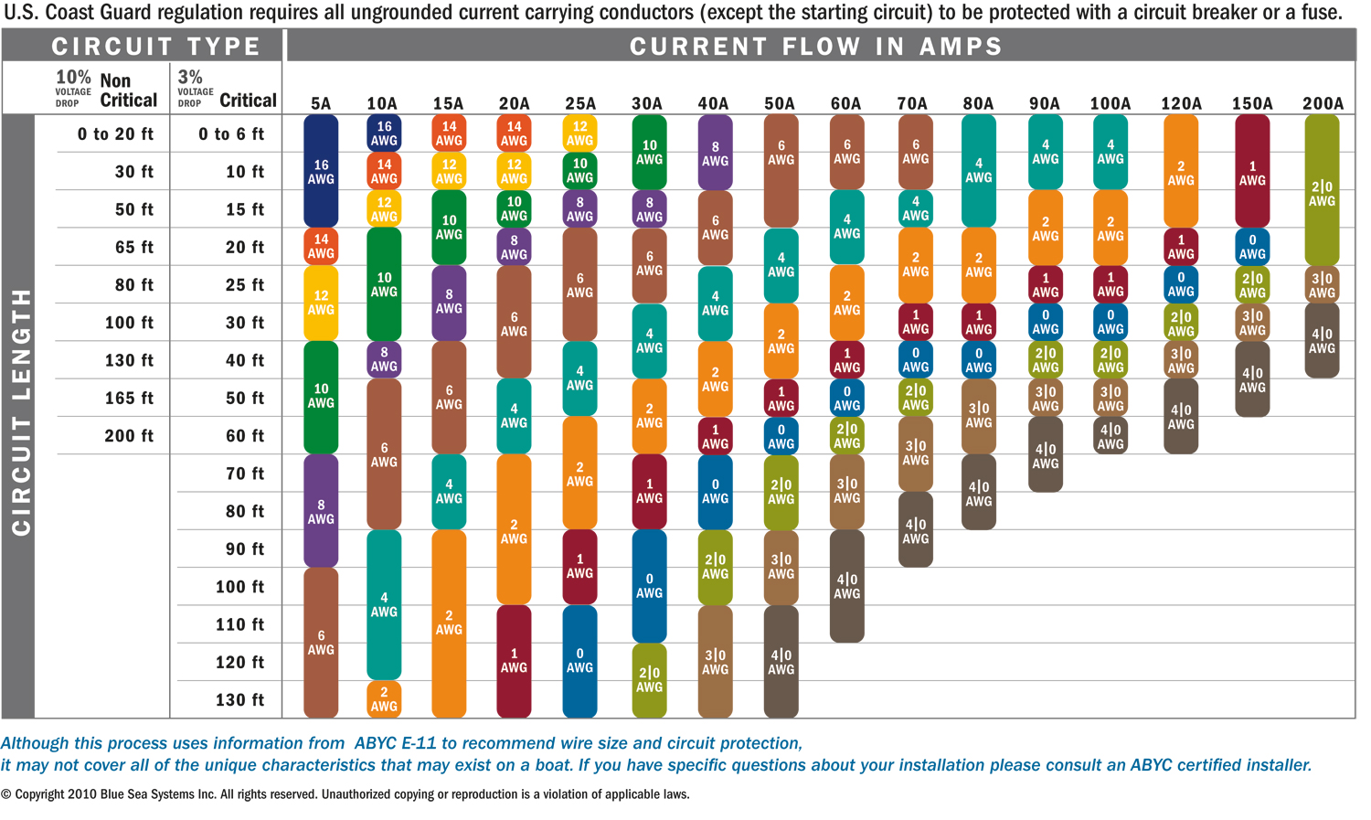

A 600-watt inverter can draw in excess of 50-amps. I would recommend either 6 or 8-gauge wiring, along with a 60-amp inline fuse. Wiring size is determined by the potential amperage draw and the length of the round trip wiring run.
http://4.bp.blogspot.com/-_VRM_ZGUKdc/ViOeH4m70tI/AAAAAAABdd8/tp6hj68cVTg/s1600/DC%2Bwire%2Bselection%2Bchart.jpgies have more range than we do

Guessing at wire gauges is like guessing at tire pressures. Rather than guess, you can make certain by using a voltage drop calculator.
That one has a number of choices, and may look confusing at first, but here's how to use it. Start with these basic settings, which will be the same for most 12V RV wiring (other than in the engine compartment):
Voltage: 14V
System type: DC
Conductor type: copper conductor
Conductor temperature: 60C (for indoor wiring)
Conduit type: no conduit
Parallel runs: single set of conductors
Now just fill in the cable size, load current, and length of cable in feet (one way), and click the Calculate button to see the voltage drop in percent.
Bear in mind that what seems like a small percentage can be a substantial voltage drop. For example, a 3% voltage drop doesn't sound like much, but it will take you from 12 V to 11.6 V, which can be marginal for some appliances.
This is even more important if you're wiring up a battery charger or solar power system. Let's say your batteries need to be charged up to 14.3 V, and that's what your solar charge controller is putting out. But if you have a 3% voltage drop between the controller and your batteries, they will only see 13.9 V. At that rate, they may never be fully charged! So while a few percent of voltage drop may be tolerated by appliances, when it comes to charging batteries, it's best to keep voltage drop under 1%.
This is even more important if you're wiring up a battery charger or solar power system. Let's say your batteries need to be bulk charged at 14.3 V, and that's what your solar charge controller is putting out. But if you have a 3% voltage drop between the controller and your batteries, they will only see 13.9 V. At that rate, they may never be fully charged! So while a few percent of voltage drop may be tolerated by appliances, when it comes to charging batteries, it's best to keep voltage drop under 1%.
The voltage drop calculator is easy to use and gives an exact number, I like it.
Voltage drop is tough for many to understand and why knowing the size and length of the wire runs is so important when setting up charging systems and adding high-power usage devices such as large inverters. Keeping the voltage drop low is a prime design concern, thanks for the explanation.
