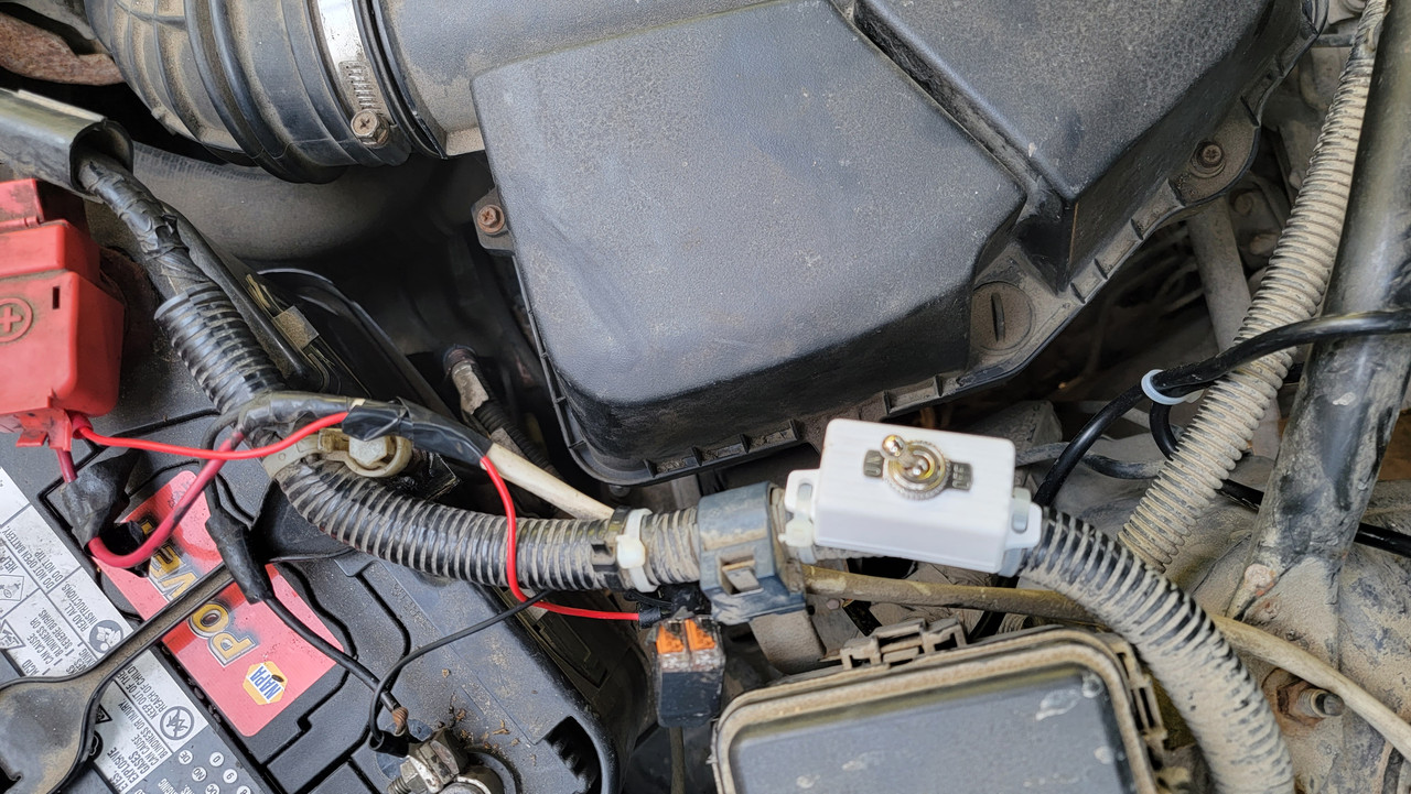

Where did you mount the repeater and where did you tap into the power?

Hi Ted. I mounted the repeater antenna on the inside of the valance for the back window. It has a free range  toward the back for reception, and repeats toward the receiver through the motorhome. (of course both are omnidirectional). It isn't normally visible.
   I picked up power from the light in the underneath side of the cabinet, and the cabinets hollow floor had enough toom for the mechanism. Getting the staples out of the floor of the storage compartment was the hard part.  RonB
   edit, I forgot that the 12VDC wiring was added by me for the light I put in earlier., so you might need to run that wire into the hollow floor. RB

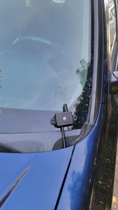

I wrote the company asking if I could mount it in my tow vehicle.

What's a good three-way wire splice to use?

After using wire nuts and butt connectors for years, I like wago connectors now.
https://www.youtube.com/watch?v=rMlI7qOm8hM&ab_channel=SilverCymbal
Rich
Thanks.
These do look nice.
Wago 221-413 LEVER-NUTS 3 Conductor Compact Connectors 10 PK Amazon.com: Wago 221-413 LEVER-NUTS 3 Conductor Compact Connectors 10 PK :...

Hi Ted. Did they answer your question about mounting the unit in the tow vehicle?
Re: Tire Pressure Monitors
I just called TST.
The repeater has a 100 foot range and can be mounted on the tow vehicle no problem.
That solves that issue.
I installed the repeater and added an on/off switch.
