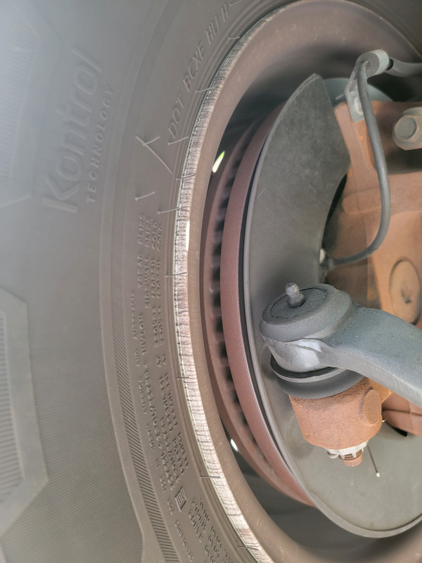

I’ve been crawling under the rig trying to find where I can install some Zerk
fittings for the ball joints. I’m not that familiar with suspension parts but are these not the ball joints? If so, I don’t see any place to add Zerks. Does anyone have any photos of the ball joints with Zerks installed?

It appears yours have a circular cover that if popped off might reveal a threaded hole - but not certain. Someone else weigh in?

More photos. Is it possible the newer chassis does not allow Zerk installation?
Re: Ball Joint Lubrication
The current OEM Motorcraft ball joints are sealed "lubricated for life" units. However, Moog and some other manufacturers do offer ball joints for the E450 that have zerks or are threaded for zerks but are plugged.
Yes, thanks for the photos! After three trips underneath to look, it wasn't obvious to me how Zerks could easily be added. No plastic plugs or metal bolts were observed.
Those are steering linkage (tie rod, drag link, and steering arm joints) lube points, not ball joints.
Both upper and lower ball joints are in that picture. There are no zerks or plugs. Like Larry W said, Ford now only uses "lubed for life" units so you have to go after-market for units that can be lubricated.
Reply #20
What you see is what you get.
Without the capped, threaded holes, there is no way to install grease fittings, forget about drilling and threading the existing ball joints for fittings. There is no way to do it that will prevent metal shavings from entering the ball joint's mating surfaces and destroying them.
Ford must be saving big bucks by eliminating the possibility of grease fitting and is ensuring that the ball joints will need replacement before the rest of the suspension and steering parts need replacement.
