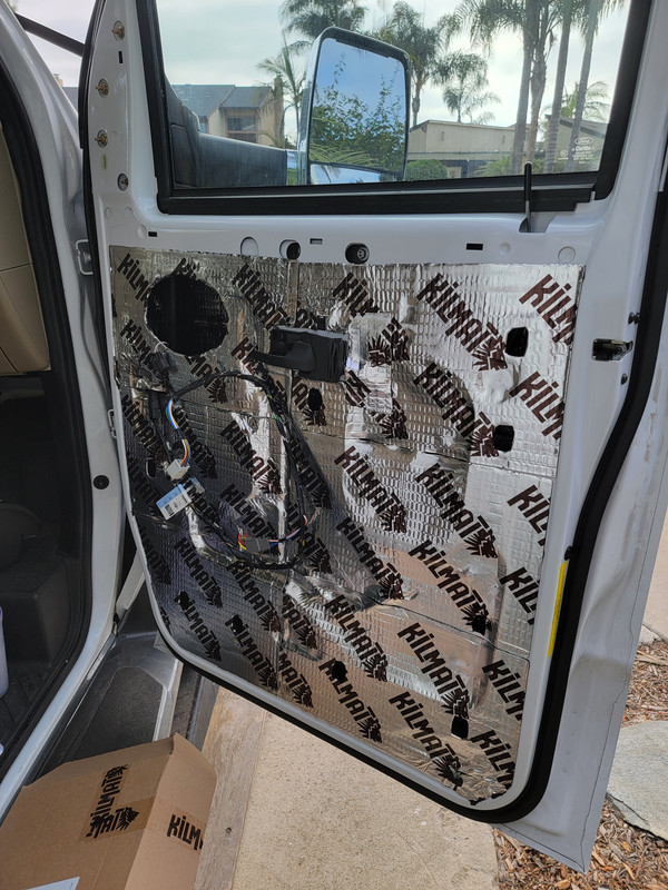

Literally just ordered the same sound deadening material and roller. Everything is supposed to arrive Sunday. Hopefully in time to have a fun project for the day.

Re: Replacing stock speakers
Working on it today.
I also put a layer inside.
Looks really clean. My kit is coming tomorrow and depending on the time it arrives I may try and tackle it. i already received my speakers and harness. Did you notice if you had to chance the polarity using the harness? The only downside I see is if you ever need to swap out your window regulator. Would be a pain to have to pull that all off and out of the way to access it.
