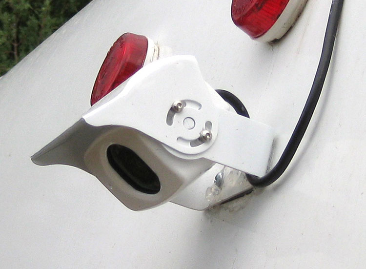

This is what we have used for the past either years, it's obsolete but there are many models like it available today.
Amazon.com : Rear View Safety Backup Camera System with 7" Display (Black)...
A hardwired system has the camera powered through the cord, a wireless system will need to be hardwired to a 12-volt power source, have its own replaceable battery, or a solar power/battery. I prefer the dependability of a hardwired system but it does take more work to install.
Backup camera & monitor | Flickr
Re: Back-up camera...
Thanks, Larry.  I did see your post in my search and especially like the backplate idea on the camera mount.  Good info.
-Bill
