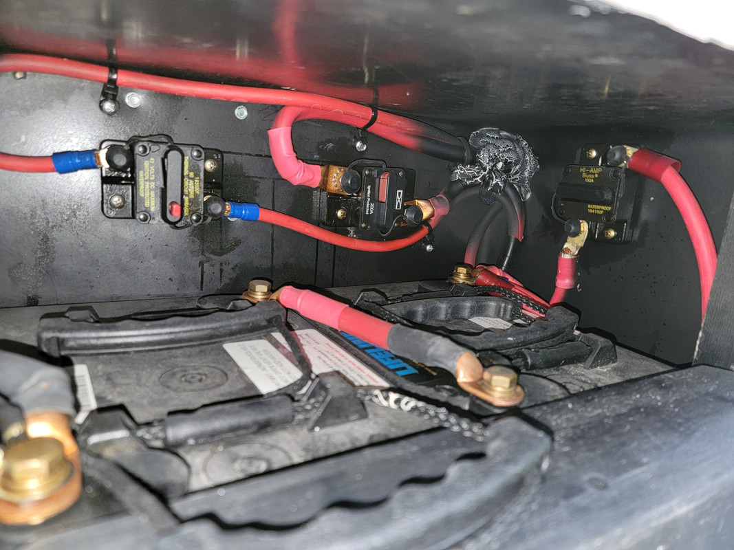

I'm wanting to install both a Bluetooth battery monitor shunt and a battery disconnect switch here.
The left side has some room but is it enough?
P.S...bonus points for anyone who can tell me what those mounted switches control. I'll recheck the manual but I don't recall seeing that info.

Aren't the circuit breakers going to the converter and vehicle alternator, the third one I don't know.

The battery disconnect typically replaces the jumper between the batteries, and mounts on a thin fiberglass card that slips vertically between them. The third breaker might be to the generator.

Here's a dumb question: if you turn off all three of those breakers, have you effectively disconnected the battery, and hence don't need a battery disconnect switch?

I need to look at a new LD and see what the different breakers do, they are all large breakers, a 90-amp. 150-amp and a 200-amp
The 200-amp may be a battery disconnect, impossible to say without looking.

Hi Andy and Ted;  the 90 Amp breaker is the only one with a 'trip' button.  The 150 Amp and 200 Amp apparently do not. They have reset levers to reset them if they trip, but can't be just turned off.  If the 200 A goes to the generator starter motor, and the 150 A is the wire coming from the engine alternator, those can be left on. The 90 A, I believe, is the one going to the converter, and actually serves double duty.  It is charging current from the converter, going to the batteries, and when not connected to shore power, the converter uses that same wire to connect the batteries to the house 12 vdc branch circuits.  So yes, pushing that red button to trip that 90 A breaker would 'shut off' the batteries.  While 'Shut off', the generator could still be started, and the truck chassis alternator could charge the batteries. without shore power or generator, the 12 volt circuits in the 'house' would be without 12 vdc.
     Lazy Daze, for not much extra, could have provided those two breakers with the capability to be shut off. But possibly Steve didn't want trouble calls from people who wouldn't realize what those buttons did.  RonB

Our mid-bath's battery box had less "stuff." I installed the shunt on the left-hand wall of the box; pictures are here. Your mid-bath's battery box has room there, I believe. The flexible cable on the shunt input allowed the battery tray to move normally.

Ted. There is room on the left side of the box for the monitor sending unit. That is where I placed my Victron unit. Look at my thread on the modifications to Villa Verde for the photos. I do have a emergency disconnect switch upstream to the battery negative post.

We have an MB and we installed a shunt on the left wall.  Check out this post with photos and details of the install.

The left wall is the place for the shunt in most floor plans, most of the cable are onthe left side.
The shunt can be screwed directly to the box, if you can get to the side of the box. a small, plywood backing plate isn’t a bad idea.
I mount the shunts on a plywood square that is both screwed and glued to left side of the box, this provides a solid mount without having to access the side of the box.
