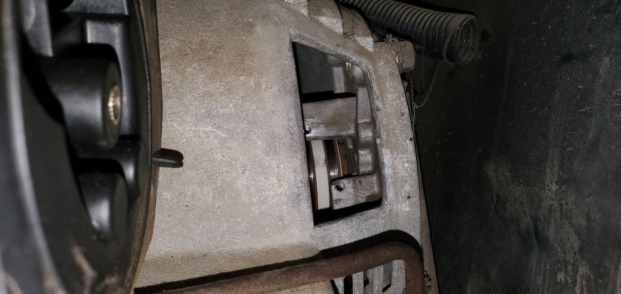

Fortunately I got to my brush assembly and removed it without dropping the generator (or one of the mounting screws LOL). This also exposed the rings for which I have a Flight Systems "Slick Stick" in order to shine them up with.
I guess the Emerald generators have better access than the newer Onans.
Glad it is simpler than I thought.
I removed the air filter housing and there it was.
The most nerve racking part was being careful to not drop one of the mounting screws. 😅
