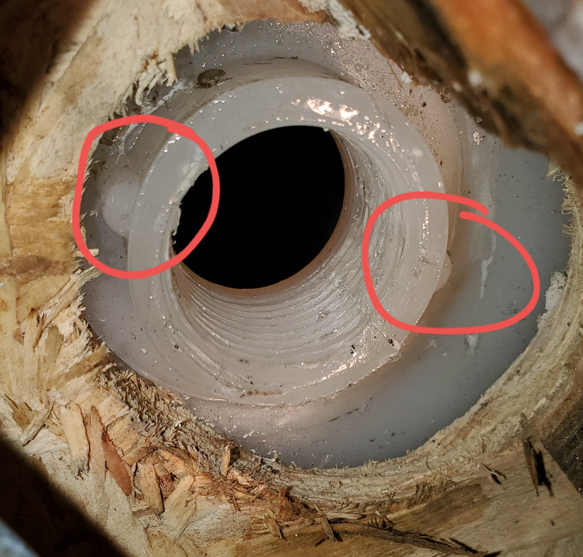

I just too this pic.
My best view yet of the crack.
It appears to not go into the body of the tank which I assume is a good thing!

It does, however, look like the crack extends through the entire fitting. I was hoping you would be able to drill a larger hole and rethread, using a larger plug, but don’t think that’s possible in this case. Larry and Ken’s solutions are your best bet, I think.
I would still want to open the crack up for cleaning and application of epoxy, the crack needs to be completely clean, if possible.
A short piece of a hack saw blade or a dental pick would still be my choice for removing the crack's dirty plastic.
Ken's description is the same method I would use.
The crack in Ted's tank could have been caused by a too long or unsupported drain pipe, the flexing could have caused the crack to appear and grow.
A protruding drain pipe could have been hit hard enough to crack the fitting.

Good pic!  That helps.
It looks like the crack extends along the length of the threaded protrusion, but not to the mating of the tank with the fitting.  If so, I would not change any of the plans discussed. I would hesitate to cut open the crack, fearing that I would spread the crack to the tank itself.  If the crack already reaches the tank, nothing to lose in opening the crack.  You might try fitting a small flat bladed screwdriver into the bottom of the crack to spread it, then scrape it clean.  That would also facilitate working JB Weld into the crack.
Looking at the pic, I think I would add one thing, if possible.  After finishing with the JB Weld, before cleaning the threads with the tap, if there is room, I would try to get a band clamp onto the fixture to hold the crack together, supplementing the strength of the JB Weld work.  I think it will be hard to tighten it ( a whole lot of little turns with a small box wrench), but I think it will add a lot to the strength of the repair.  With the band clamp in place and snugged up, use the tap to clean the threads, then do the assembly.

Thank you Ken.
A few pictures back I was able to get a band (hose) clamp around the fitting. It's the picture with the boat t handle drain plug I experimented with.
