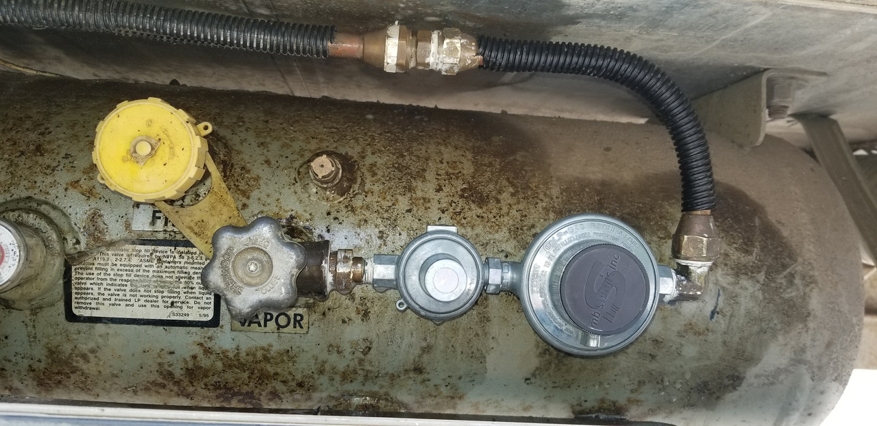

Installing a gas pressure regulator
I called MB Sturgis and they said to use either Loc-Tite or regular thread tape.
I asked if it should be a tape or dope that is propane resistant and they said no.
I'm confused.
I always thought that I needed a gas resistant thread sealer.

Thank you.
I had difficulty removing the old one did I'm going to have the rest done by a professional.
A brass nipple broke and fittings are stuck.
I don't feel comfortable wrenching that hard on that tank valve area.

UPDATE:
I realized it's left-hand threads into the tank which makes sense now. Doh!  :-*
I need a shorter line since I'm removing the external tank adapter.
Will a short flex line work?
Can I get those at Lowe's or HD?
This is the solid line I removed. I need a line about 2 inches shorter:
Re: Installing a gas pressure regulator
Hi Ted; I would avoid a flex line, especially on a moving vehicle. You could cut off two inches and put a new fitting on one end. Are those compression or flare fittings?  You could cut out the appropriate amount of tube in the middle and re-join it with a  compression union, to retain the present fittings if they are flare. (Leak check after installation required!).     RonB
Yes. They are flared.

I'm thinking this...
flare tool
Or this
Flare tool
Hello, look up the company Hose Pros. They can make a custom hose the lenth you need. Hopefully they are still in business.
All in.
Soapy water test good.
Appliances fire up better.
Frig lit right away but I need to test longer.
I cut the pipe shorter and flared II.
Thanks for the help!
